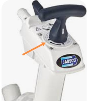

Mine doesn't have any kind of clip. Just pull up the handle, tighten the cap with a suitable spanner and don't be too heavy handed with the handle. It is just a simple quarter turn to lock the handle from lifting. Or are you using the handle to tighten the cap itself?Yes, did that but it seems to come loose again.
As its a twist (& lock) action in the handle I wondered if there was a way to stop it undoing again.
Is it broken, is there a clip that needs locating somewhere, or something else.
Surely it should not be able to undo that easily
Mine doesn't have any kind of clip. Just pull up the handle, tighten the cap with a suitable spanner and don't be too heavy handed with the handle. It is just a simple quarter turn to lock the handle from lifting. Or are you using the handle to tighten the cap itself?![]()
