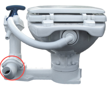

I would suspect one of the valves in the toilet, probably the foot valve as this has the smaller opening but otherwise the joker valve. Undoing the joker valve housing will allow a little water into the boat, most of which you can catch in a plastic bag. The loop will prevent the open valve from flooding the boat. If the joker valve is ok take off the pump assembly and all will be revealed.
I am not 100 on where the joker valve is. Can I just unscrew this bit and take it off there?screenshot-20230617-125012.png
Bilgediver
6 Jun 2001
8,183
Scotland
I suspect the blockage is at the Joker valbe as mentioned earlier. To prevent this in the future only use the cheapest supermarket paper which breaks down quicker than the fancy grades. This is what expensive marine toilet paper usually is.
