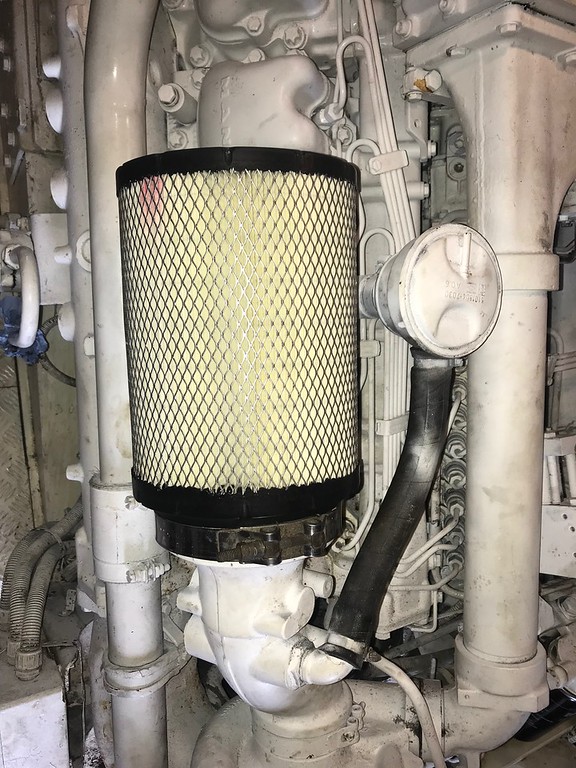

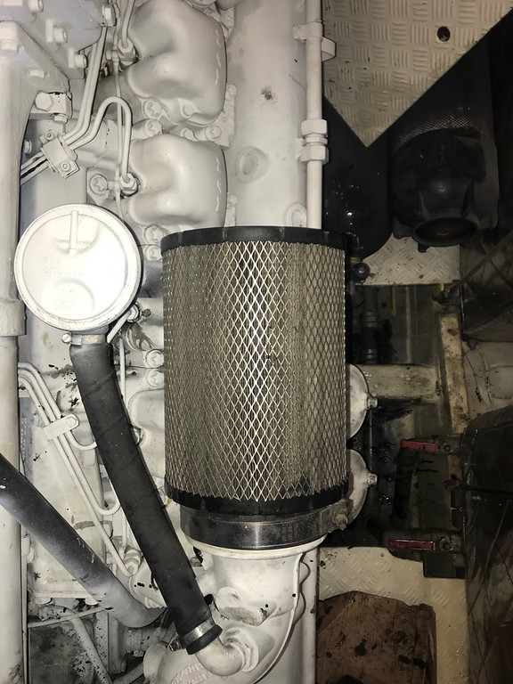

Here is a picture after 160hrs running time
And this is when new,
