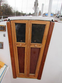

I think you are talking about a set of washboards. I made a set last winter using 12mm marine ply. The vertical sides I trimmed with oak strip and the horizontal sides with a triangular(ish) moulding to give a water run-off where the two boards sit together. Lots of coats of varnish.
I kept my tacky old boards to put in for the winter when the boat is ashore.
