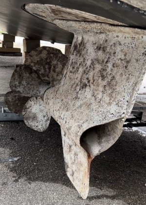

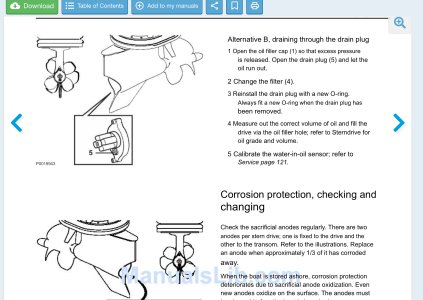

15 Apr 2023 #1 B Bridgeman Well-Known Member Joined 3 Oct 2010 Messages 363 Visit site Just wondered where the oil plug is to drain oil on IPS drives? Also any recommendations for antifouling drives. We are doing hull with Ultra 300 Cant find it in manual. Many thanks. Neil Attachments IMG_8959.jpeg 544.2 KB · Views: 23
15 Apr 2023 #2 Portofino Well-Known Member Joined 10 Apr 2011 Messages 12,443 Location Boat- Western Med Visit site
15 Apr 2023 #3 B Bridgeman Well-Known Member Joined 3 Oct 2010 Messages 363 Visit site Thank you Portofino. Much appreciated.
