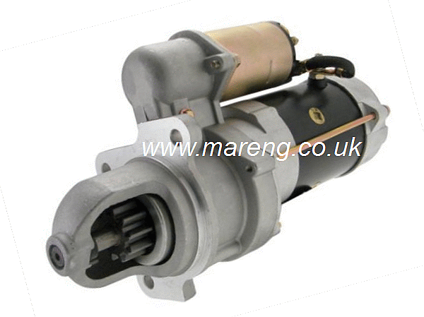

You say "Bendix (?)" so is it an inertia type starter with a Bendix gear... a pinion that runs along a spital on the shaft to engage the ring gear or is a pre-engage type where the pinion is moved into engagement by the solenoid
The 1st pic below is a Bendix type which i have found it as a part for a 6354. but I have also found pre-engage types for the same engine 2nd pic
Look for burs that may cause it to jam on the shaft and pinion and also inspect the ring gear on the flywheel. A Bendix should not be heavily lubricated ( not at all in cars where oil will pick up dust from the clutch)

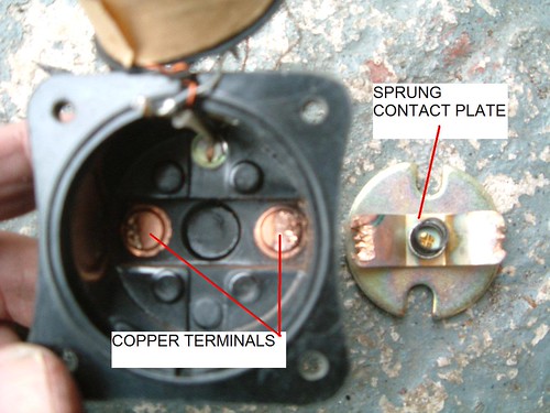

It could be burnt contacts, a bit like the picture, inside the solenoid. The result is you get the mechanical action but no power then goes to the motor.
It just clicks. They're quite straightforward to repair if you have a heavy soldering iron.
