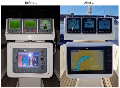

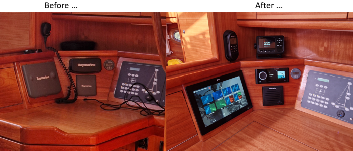

It's been a very long project, hampered by the distance to the boat and the time it actually takes pulling old cables out, laying conduit and pulling new cables through from bow to stern. Lessons learned ...
  • Take your time estimate and double or triple it.
  • Take your cost estimate and double it.
  • Get help if possible, especially pulling wires through awkward places, a small child would have been invaluable.
  • The wire lengths end up being a lot longer than you expect - our NMEA backbone is almost 30m long on a 13m boat.
  • Do 6-12 months of yoga and/or pilates before attempting a re-wire.
  • RTFM ... multiple times .... it'll save endless confusion when it's switched on and erupts into a cacophony of warning beeps and error messages.
  • Despite reading the manuals multiple times, there is much that is simply not clear - forums help, but some sh!t doesn't work as expected so it just has to be lived with.
  • Get the right tools for the job, hydraulic crimps, proper strippers, wire cutters and crimps for all electrical connections - resist the urge to bodge and do it properly.
  • Use tinned copper wire - it'll last longer and won't look like the green/black carp I pulled out of the bowels of the boat.
  • WLAN, LAN, and Bluetooth are the work of the devil and once configured and working will fail without notice on next power-up. If anyone knows how to get a Raymarine wireless mic attached to a Raymarine wireless speaker then I'd love to know - my handset just hangs up trying to connect, with "in use" on the screen and has to be switched off and on again.

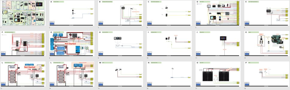

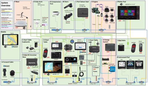

This is the plan ... (orange bits still a work in progress.)

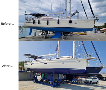

... and despite all that wiring ... this is all that is visible. Spot the difference.

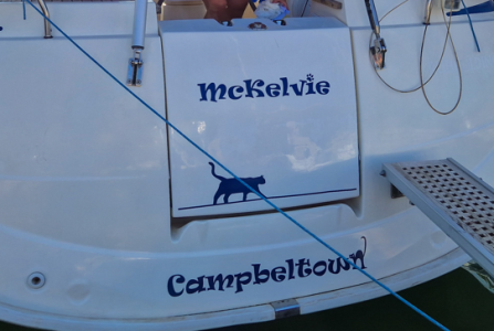

Difficult to see in the pics above, but the new boat name has a paw print as the dot on the "i" and a general cat theme :ROFLMAO::ROFLMAO::ROFLMAO: ... boat graphics were made by Leonie from Vinyl Boat Lettering - Art & Sea - Custom Vinyl Graphics, Boat Graphics based at Creran Marine in Argyll
And the N in Campbelttown is a cat

What made you go for 2xi70s rather than one of those and either the i50 tridata or i50 wind? I’m currently trying to decide what to replace my st50s with. I’ve installed one i70s but I’m leaning towards i50s for the rest. I have n2k transducers now so don’t need that head unit capability but the i50s are a bit cheaper (although not that much) and use less power. Obviously the i70s do so much more but do I need more than one given that most of the time I just want to see speed and depth?
And yes: fitting instruments: easy. Dismantling the boat to run cables: harder. I’m not a fan of proprietary connectors in general but I think anywho has had to replace old cabling with n2k probably secretly appreciates seatalk ng over devicenet
The 2 x i70s was a redundancy and aesthetics choice .... redundancy because when one dies, the other can provide all the same functions, and aesthetics because they are all the same size, resolution, and design. Apart from the cost, I do like SeatalkNG, my backbone is 28,8m and it was not fun laying the conduit and pulling the wires through.
