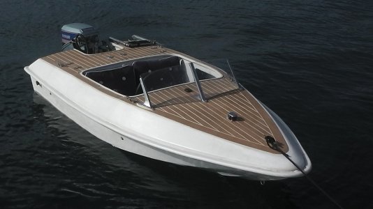

Thank you guys. My current much loved tender pictured is only 3 metres long but is too heavy to manouvre alone onto the chocks when there is some swell and water is sloshing about over the submerged hydraulic platform. BTW is there anywhere on the forum I can advertise it for sale? I have rather sneakily attached a photo.

That's only 3 metres long?? That looks excellent!! What motor are you running on the back?

Yes, and a special motor mount allows the Evinrude 9.9/15hp. to lift up then pivot around sideways leaving the required space on board at 3 metres. Only one pin to remove leaving all controls attached.
