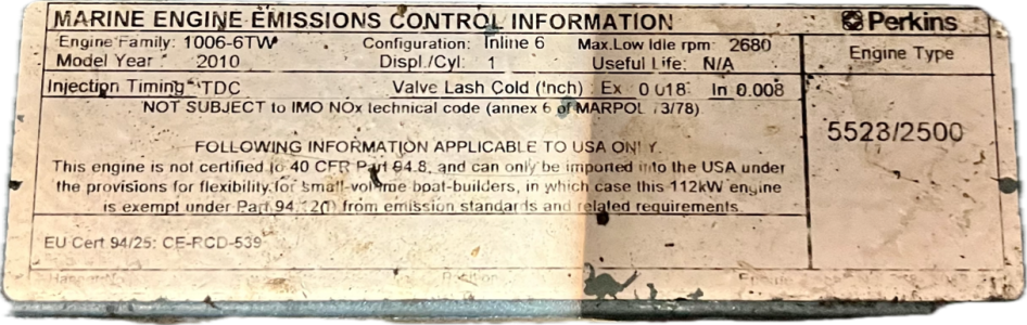

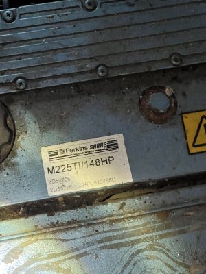

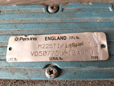

There are the engine plates. One of which is loose. Two others are still attached to the engine. All the numbers match. I have attached the photos.
Here is where my brain starts leaking out of my ears.
The emissions plate says:
Engine Family 1006-6TW
Year 2010
Engine Type 5528/2500
The engine sticker still attached says:
M225TI/148HP
YD50756
YD50775/150HPU913458U
The metal stamped engine plate says:
M225TI/148HP
YD50775U907458U

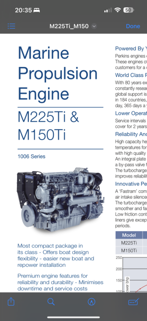

The build sheet for my boat says Perkins M150ti and matches my serial number. Nothing else I find mentions a M150ti.

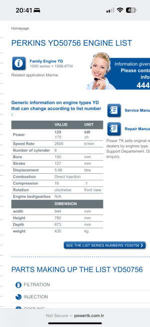

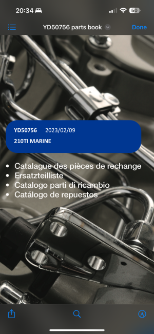

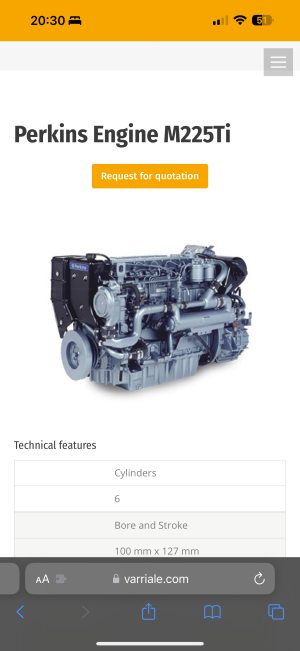

The Perkins App wont even accept my serial number if I use the YD50775 part. It will only accept the whole number if I use YD50756. But then it tells me the engine is a 1006-60TA not a 6TW like the emissions sticker says. And if I click the parts book link, it builds me a parts list for the YD50756 M210TI. Not to mention there are no Sabre parts in that list book.

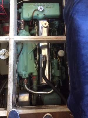

Can you post more pics of the whole engine and tell us sbout the boat, gearbox ratio, prop and performance you get?
M225ti and M215c were exactly the same thing, rated differently and were 204hp.
On the emissions sticker it mentions 112kw, which is about 150hp. I'm guessing this may be a de-rated version of the M225ti engine for commercial use or the like
I think so to. I think its M225ti hardware with injection pump down rated to 150hp, that would have made it a perfect replacement for an ageing T6.354 145hp which would have been a key target market for Sabre.
With respect to the OP, the paintwork in the photographs suggest more wear than a 2010 engine ought to have 😳
It makes my 1987 Ford/Sabre 2728s look lovely 😍 Tolerance Engine 5.jpg
