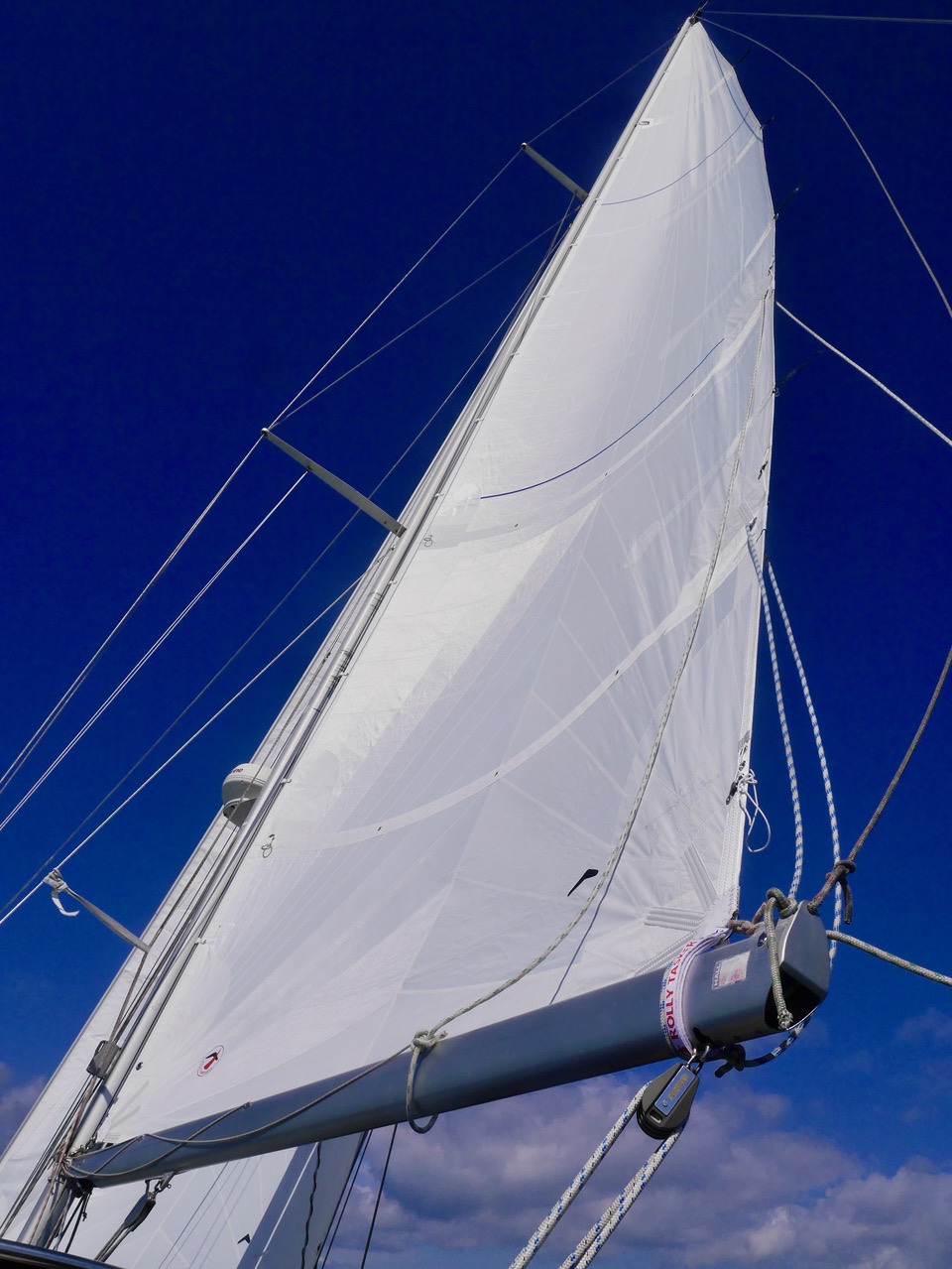

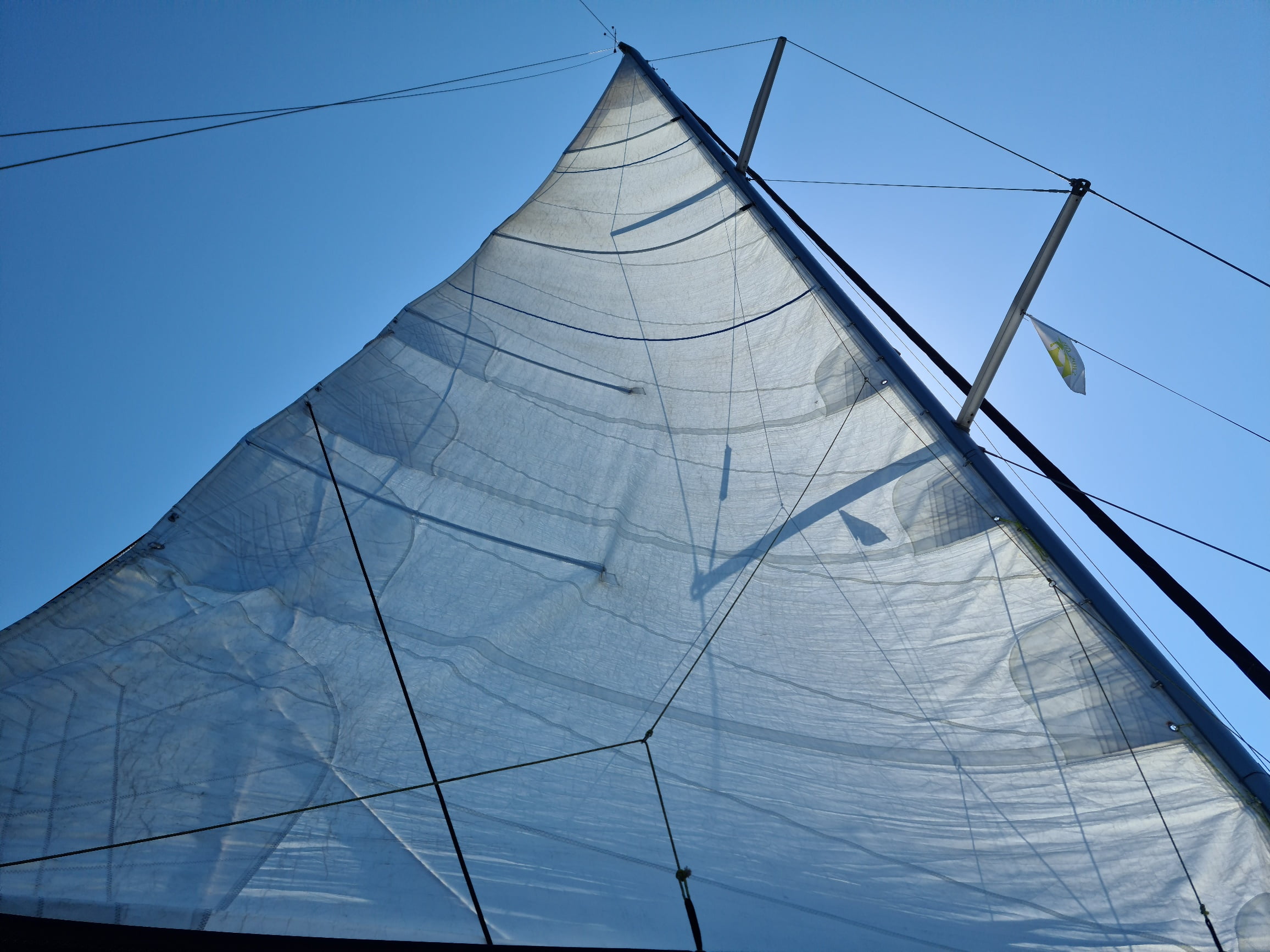

As a novice I'd probably think a sail was fine unless it appeared visibly tattered - so how to tell?
I've tried describing this twice, and deleted what I wrote because it was unintelligible. I'll try pictures.
This is a good sail.
This is not.

We may be able to help from photos, but ultimately the best way is to take someone with you who is reasonably expert. Alternatively, wait until you have enough experience to judge properly, but this could take some time. Old or badly-set sails will still work but you may lose three quarters of a knot in speed or fifteen degrees going to windward.
