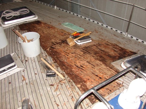

When my wife and I removed our teak decks (laid on epoxy but broadly same principle as sika) we used a mallet and chisel. I didn't find it too bad but it was terribly slow, my wife (we had 2 sets of tools) struggled.
I went and bought this electric chisel
http://www.axminster.co.uk/arbortech-pch350-power-chisel
(I tried the cheap Bosch one - that lasted 15 minutes)
It came with a flat 19mm chisel as well as the round wood-carving one in the picture.
Chalk and cheese - I could sit back with a cup of tea whilst my wife beavered away like a mad thing!
Actually I only bought the Arbortech head from Axminster and sourced a cheaper (but compatible) grinder to fit it on.
The Arbortech head lasted the removal of the teak (12m yacht) before wearing out but it was worth every penny.
And no, I/we wouldn't do it again.
But the end result (new teak deck) was worth it.
BTW. We both suffer from pains in our hands now (18 months on) - don't know if it was the electric chisel, the mallet & chisel or it's just plain old age.
Here's a video of the chisel (& my wife) in action

The blue cover was really strange to work under - the sun looked like it was constantly setting when you looked out through the open ends and some colours inside went dull while others picked up a fluorescence - weird man :cool:.
