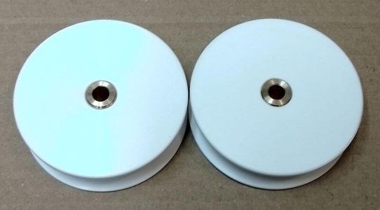

The following did work:
Drilling holes into the plastic (nylon?) sheaves down to the spindle sufficient to ruin middle of the sheave where the spindle was stuck, then knocking the spindle out with a hammer and punch.
Replacement sheaves cost over £8 each .. for a plastic wheel 45 mm in diameter.
Find someone with a lathe and ask them to turn you some sheaves in Delrin instead of nylon. Delrin doesn't expand in water.
