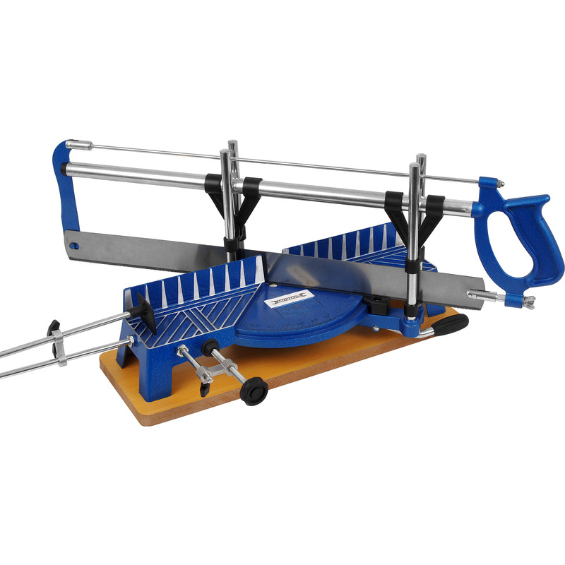

Or by hand use one of these set al 90 degrees.
This with a metal blade will help to control the accuracy of the cut.
