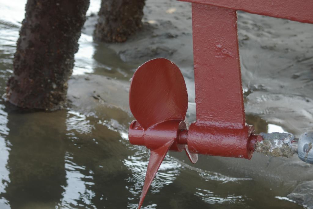

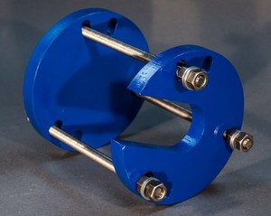

Sometimes pullers don't fit very well. I am a fan of 'ringing', as above deadweight and lump hammer, never failed for me, but my prop was 28in diameter so lots of meat. A more correct engineering method would be to drill and tap two holes in the prop boss looking forward opposite sides of the shaft hole. Then a steel plate with similar spaced holes is placed across the shaft nut, and two bolts wound into the prop to pull it to the steel plate, or use them to bolt the puller to the prop, rather than trying to get round the blades.
