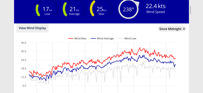

We’ve probably wrecked a set on our XOD this weekend.
That’s more than we should, by rights, be sailing in. That is the wind at Lymington platform on Saturday. But it was our home regatta, so we felt a bit obliged. Laminate sails would stand up to that, but our Dacron sails are stretched.

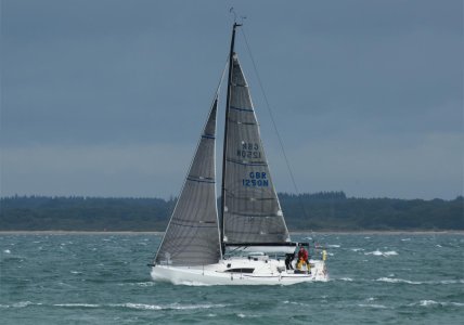

On the same day these 13 year old laminates took us round the island doublehanded fast enough to win it. Coupled with one kite of the same age, and one that was made originally sometime in the 90s we think, and I bought off Facebook marketplace to be a chicken kite.
As the main is our "offshore" main for a boat that seldom does any offshore, then whilst it definitely hasn't had 13 years of use, but it is the only race main we have with reef points, so it does generally come out when it's windy and was our delivery main for years too. The shape is still absolutely fine, but as with all 3DL sails of that era, the plastic is starting to crack, especially at the leach, and it's accumulating patches at an ever increasing rate.
The jib is our J4, and that does get used any time the wind goes above about 22-23 knots. Again, shape is still fine.
An interesting point in terminology, I would have described your sails as moulded or string sails rather than laminate sails. Though I realise that the technology is ultimately laminate technology, ie layers glued together, it's quite a different construction method to oriented panels of prebuilt material stitched together in a triradial pattern.
Certainly they look to be in good shape for 3DLs of that age which is good to see. I've been hearing more about filmless moulded/string sails which apparently avoid the delamination issues of film over string
by glueing the taffeta/liteskin straight over the string rather than on top of the film to then later have the film delaminate.
Fair point on the laminate / moulded distinction.
3DL was superseded by 3Di, which is a filmless moulded sail. The oldest 3Di I have on the boat is also 13 years old, as the tech was brand new when the boat was new and the 1st owner tried one sail, the J3 in it. That sail, despite a long hard life, is still immaculate and in use as my cruising jib. Honestly, every time I put it up I look at it and think "this is just as good as the current J3". It is a bit heavier though, so I suspect that being at the start of the tech they possibly slightly overbuilt it.
