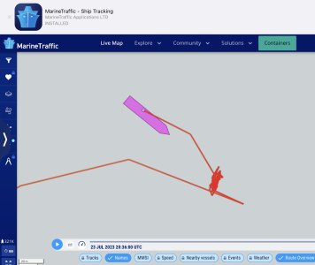

One useful way of monitoring your boat and others when ashore is to leave the AIS on and use one of the many internet apps to check the position. If you zoom in using track history, the swing can be seen so even a small drag can be picked up.
It is especially useful for monitoring other boats in the anchorage (which I indicated in a previous post is my biggest concern).
For example, below is the track history of a boat on Marine Traffic. The arc shows it is maintaining a nice steady distance from the anchor. You can click on any other boat in the anchorage that is transmitting on AIS to see if their swing radius is stable. This is useful even if you are staying on the boat.

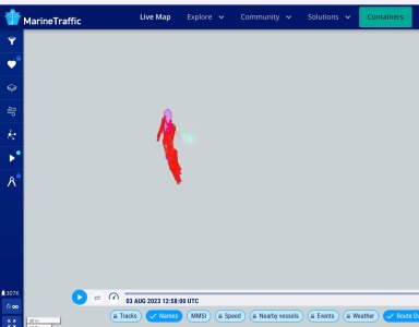

Below, for example, was the plot of a boat dragging near us just a couple of weeks ago. The plot provides some nice information such as where the direction where they dropped their anchor and also shows the drag distance and the fact that their position has not stabilised. This shows they have not just let out some more chain and also shows that the anchor has not regained grip.

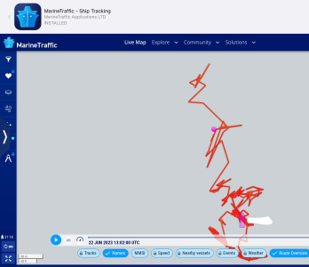

This is another recent example. This boat was directly in front of us. I have removed the boat name to not cause embarrassment.
It was much more chaotic because the skipper elected to use the engine for a couple of hours to reduce the dragging and to keep the boat in position while the weather (a nearby tropical storm) passed.
In this case radar was more useful as we were aboard our boat, but it was still helpful to see the track history of the dragging boat. This information is not available via radar.
