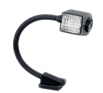

Can anyone help me as to how to open a Hella 4532 chart lamp to change the bulb to LED? It should be simple but I am not finding the solution and do not want to break it in the process. Many thanks.
I have taken one of these apart but to lng ago to remember certainly. I think there's a wee notch in the left side of the lens as seen in the photo. Poke a small screwdriver blade in there gently and the lens pops out.

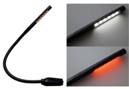

I was going to suggest a replacement that you could switch to red for night use, either mechanically or electrically. I fitted a Labcraft Dual Colour LED light but looking at the Hella, it appears they come with an alternative red lens so they must be very easy to pop in and out. Check the back of your cupboards and trinket drawer, the red filter might be in there.

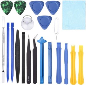

Yes, it was as simple as removing the transparent lens - using a plastic tool - by means of the small slot/gap built into that lens. I was a bit mislead by evidence that a previous owner had tried to prise apart the outer black plastic casing. Those scuff marks have now been removed with some very fine sand paper. Thank you everybody for your wonderful contributions. Another tick in my very long to do list.
