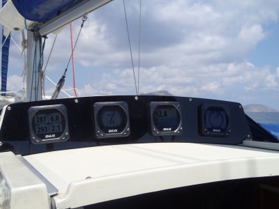

Our GRP hatch ran on aluminium runners with no other bearing surface. Over years the GRP wore itself and the aluminium, creating a black deposit that always seemed to find its way onto our hands and clothes. I lined the GRP with some thin L section PVC bought in B&Q, stuck on with Sikaflex. It is just visible bottom left in the photo. Solved the problem completely and improved the action of the hatch by reducing friction.P6100013.JPG
