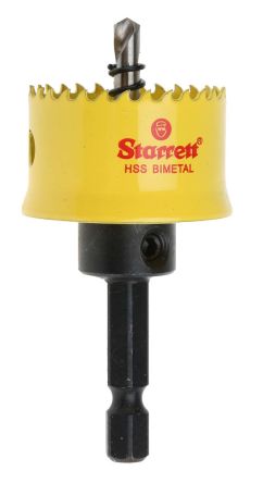

Screwfix have a range of holesaws, and both Starrett and Bosch are good quality. I have some of both, and each does the job. well. I do use tool lubricant, as I have some, and it helps.
