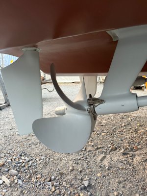

My Azimut with Coppercoat.

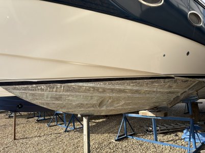

Im on the cusp of buying 8 litres of coppercoat tomorrow (Friday) instead of using the eroding antifoul. Because of various deadlines I need to apply the coppercoat monday or tuesday but i’m a bit short handed at the moment. I will need to use a 4” roller because of the strake spacing. I’ve nearly convinced myself i could mix 0.5L at a time and apply that myself within around 30 minutes (before it starts to cure). So I could just about apply 4 coats in around 9 hours allowing 1 hour for measuring/mixing etc. Start at 9am, finish at 6pm. Clearly that’s too late at this time of year so either 2 people or I do one side Monday then the other Tuesday.
What does your experience tell you about whether this is realistic? Ideally I need to find another fit /competent person to team with on this….

Seems a major task to get the hull stripped, faired and prepped for copper coat by Monday on your own, how are you removing the last of that AF?

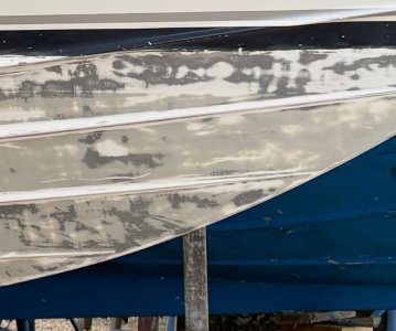

Down to an original coppercoat layer. Have sanded off all the green (oxidised copper), the grey is some form of primer on the gelcoat. All smooth and hard. Around 3h sanding remaining to finish 😁IMG_3205.jpeg

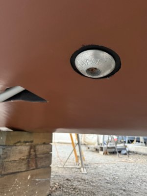

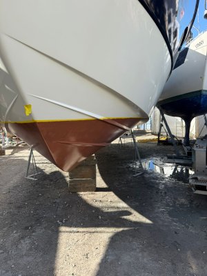

Mine was applied last week. Ambient was 15c, and a bit of breeze to help cure.
