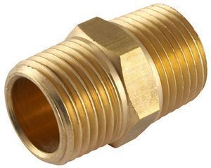

Available from Amazon UK for 2.59 GBP each in brass.
https://www.amazon.co.uk/NPT-Male-Adaptor-Nipple-Water/dp/B00B9BN3QM?ie=UTF8&*Version*=1&*entries*=0
thanks for the follow up replies everyone, I appreciate the effort - colhel has kindly offered to make me a pair. The ones on amazon, ebay etc all have BSP tapered ends on - I phoned all the various companies up and they are incorrectly described. I could probably use a BSP tapered male adapter its not a high pressure joint, but as Colin has offered I would rather have the right thing for the job, otherwise it will just niggle me.
If they are incorrectly described sorry for that. When I was in need of some strange fittings I tended to make by own by cutting the required ends and welding together mostly in stainless steel.
Hi Roger, I did alert Kevin to your link :encouragement: Disappointing they weren't as described.
Edit:: Looking at the picture again, even though one end doesn't appear as tapered as the other, it's normal for BSP thread to seal against the (hex) shoulder. Looking at the picture there doesn't appear to be enough shoulder to affect a good seal
Yes my thinking was that it was tapered both ends and I know OP specified parallel at one end generally you can fit a tapered male into a parallel female but not the other way round.
There was a couple of other links that claimed to have the BSP to NPT adaptor but don't know how true that is.
