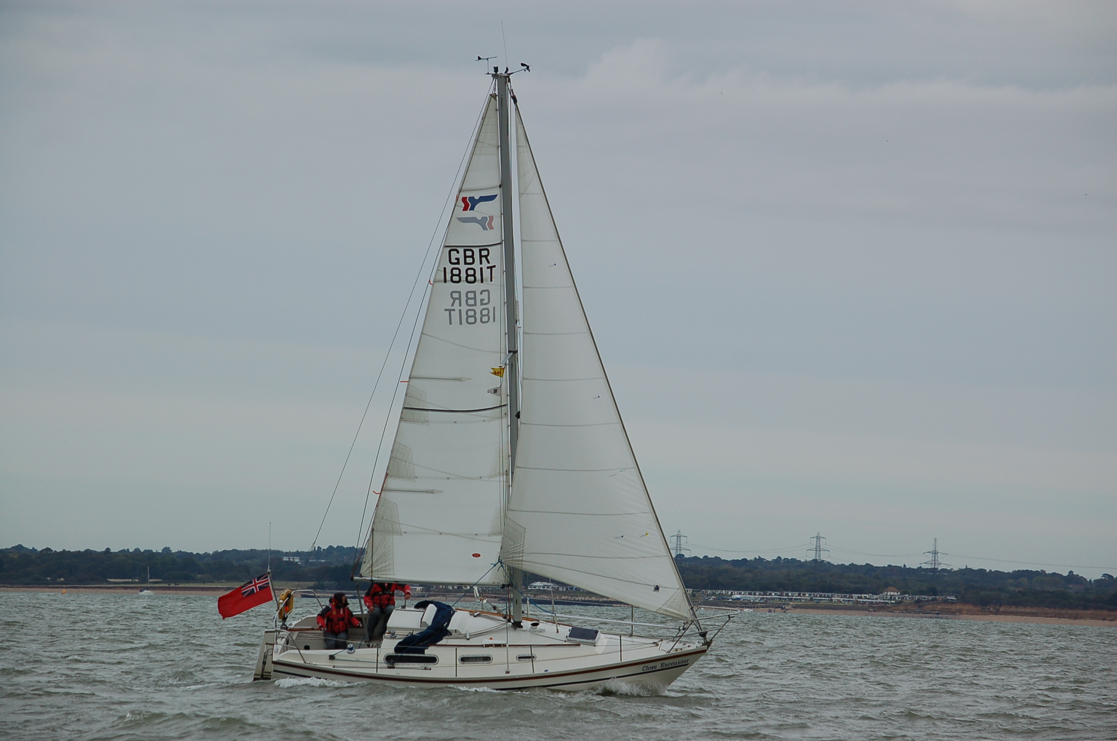

We had a full height No.3 on our Sadler 29. The furler had 2 grooves and we had 2 halyards but we very rarely changed sails at sea. We took off the headsail when we got home and hoisted either the big genoa or the No.3 to suit the expected conditions when we got back to the boat. Picture is probably near the bottom of its wind range. We often carried it unfurled with two slabs in the main. A bonus was the much improved visibility forwards when compared to a deck-sweeping genoa.
