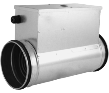

I wondered about adding a 500~1000w axial electric heater inline along the output duct from a Webasto then running that on fan only so I could use shore power to gently heat and ventilate the boat. The idea being circulated & pressurised warm air would work as a dehumidifier as well.
I see a lot of people use a 500w heater together with a dehumidifier but my thought was a background heater installed to avoid packing & unpacking stuff each time the boat was used in the winter.
I think using heat as a dehumidifier will use a lot of electricity. Better to dehumidify the cold air with a desiccant such as Meaco and use heat to prevent freezing.
