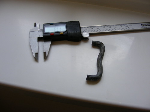

I have just broken my 8mm mooring chain, the failure came in a weld of the link nearest the stemhead. The mooring had become fouled on itself causing it to shorten, and spring tides did the rest. At failure point the foredeck was awash (32 ft boat) so several tons of load. I guess it finally went due to shock load in the wash of a passing boat

The broken link survived, I will try to post a photo soon.

Here is the broken link.
Looks like it held to the bitter end.
BTW, the calipers were a Lidl special - what a cracking buy for under ten quid!
