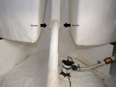

You are probably going to have to drop the whole mechanism out the bottom of the boat. Easy as it will drop out if you remove the nut and bolt through the keelbox. You will need about 3 feet clearance under the boat. The keel weighs 90kg so will need a way to support the weight as it comes down, or take the bolt out whilst on the ground and raise the boat. I used to do this with a couple of gantries and lifting gear whilst it was on the trailer.

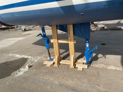

I rest the lower end on the ground with it half down and put a jack at the top end and lower it down on the jack. It slides down but beware as the end comes out the hull, you have to support it so it won't drop sideways. It's 90kg so very hard to mange. Really needs 2 people.
Thank you. I'll keep it in mind. I will do it with 3 guys minimum.
Fixed it yesterday. Wasn't as difficult as I thought. Thanks for the info.
