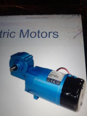

Wow £3k, must be gold inside and platinum casing.I found this. Very little info other than that eye-watering price.
Probably a bespoke motor which would explain the waiting list and ridiculous price. Getting close to the cost of an EV motor.Wow £3k, must be gold inside and platinum casing.
Well, custom designed motors can be tailored to meet specific application needs, possibly optimised for torque?Probably a bespoke motor which would explain the waiting list and ridiculous price. Getting close to the cost of an EV motor.
Yeah. Getting the roof moving probably requires a torquey motor alright. Just thinking about the location, those motors usually drive a belt or belts, likely one each side of the roof and the motor in the middle?Well, custom designed motors can be tailored to meet specific application needs, possibly optimised for torque?
The torque comes from the reduction box and I think there was a gear on the shaft.Yeah. Getting the roof moving probably requires a torquey motor alright. Just thinking about the location, those motors usually drive a belt or belts, likely one each side of the roof and the motor in the middle?
There is. And although we can't see it, there has to be a 90° turn in there as the gear is offset from the motor shaft.The torque comes from the reduction box and I think there was a gear on the shaft.
On the princess or at least on a v39. The motor is aft of the roof on the ceiling board. I think the middle one. Not sure where on a fairline though.Yeah. Getting the roof moving probably requires a torquey motor alright. Just thinking about the location, those motors usually drive a belt or belts, likely one each side of the roof and the motor in the middle?
I think this is your baby
Very like it. Well done that man. Pity Fairline don't publish the specs on their parts website.I think this is your baby
Where did you get the picture?He find it on the motor label, I suggest he takes it off tries it direct on a battery reverse the polarity to check both ways.

It's a worm drive - you can see that. That's what gives both the reduction and the 90 degree turn.There is. And although we can't see it, there has to be a 90° turn in there as the gear is offset from the motor shaft.
Excellent hunting - an exact matchI think this is your baby
