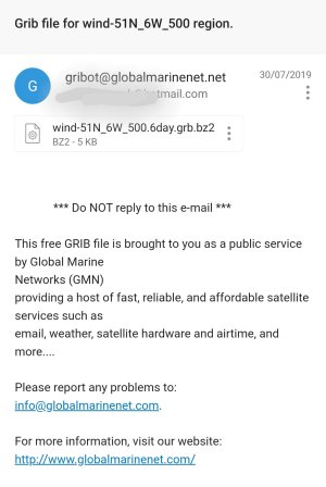

To receive a grib for a specific area, with specific resolution it is possible just by sending one brief email. Half a minute later you will receive the grib file by mail. You can set to be received on a schedule but if you don't download for a few days, you'll have more email building up.
Try sending an email with blank subject line to gmngrib at globalmarinenet dot net
You will receive an email with instructions.
I have used this method offshore and with a quick dial, email send... wait a minute.. then a minute later and you'll have a small grib file in your inbox.
There may be better methods but rather than spending money on services, compression hardware etc we found that hardly any data/airtime was used each time.
You receive an email like this
Oh and you need to be able to extract the bz2 file but your laptop should be able to do that.
