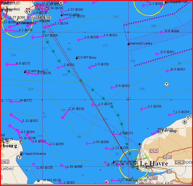

Thanks guys... data for Robin
Wanted to leave Sandown at 0300 on 10th April and working on 5kn.
Initial rough plan indicated West current at av of 2kn for first 5 hours, slack and then East at av 2kn for next 5 hours, slack then West for final hour or so.
This would put us a few nms west of Le Havre.
Lots of responses allude to the simple cancelling out of the tides which happens to a great extent on this passage.
My interest was in the efficiency of steering a straight course over the ground versus maintaining the calculated heading and allowing the boat to go off course and come back when the tide turns. IE ignore the GIS off track error.
On this particular passage assuming that the ( lovelly force 4 steady wind) is from the SW then the leeway would probably cancell out the Westerly offset at leHavre
This is the COG for the date and time, then see below for the differences every hour for 24 hours and the CTS based on your chosen time. I did this quickly after a very fine Rioja so as they say, 'not to be used for navigation'!!
RESULTS ARE FROM DERIVED DATA AND AS SUCH ARE ONLY APPROXIMATE
Optimise Departure for 10 Apr 2012
Start : 50.41.70N 001.04.08W Range = 84.1 nm
Dest : 49.29.47N 000.03.03E Bearing = 149.2 °T Speed = 5 kt
Departure Time 0:00 Arrival Time = 17:21
CTS = 146°M Time Taken = 17:21 Distance through water = 86.8 nm
Departure Time 0:30 Arrival Time = 18:05
CTS = 146°M Time Taken = 17:35 Distance through water = 87.9 nm
Departure Time 1:00 Arrival Time = 18:15
CTS = 146°M Time Taken = 17:15 Distance through water = 86.3 nm
Departure Time 1:30 Arrival Time = 18:46
CTS = 148°M Time Taken = 17:16 Distance through water = 86.4 nm
Departure Time 2:00 Arrival Time = 19:00
CTS = 147°M Time Taken = 17:00 Distance through water = 85.0 nm
Departure Time 2:30 Arrival Time = 19:23
CTS = 149°M Time Taken = 16:53 Distance through water = 84.5 nm
Departure Time 3:00 Arrival Time = 19:44
CTS = 148°M Time Taken = 16:44 Distance through water = 83.7 nm
Departure Time 3:30 Arrival Time = 19:56
CTS = 150°M Time Taken = 16:26 Distance through water = 82.2 nm
Departure Time 4:00 Arrival Time = 20:26
Departure Time 4:30 Arrival Time = 20:48
CTS = 151°M Time Taken = 16:18 Distance through water = 81.6 nm
Departure Time 5:00 Arrival Time = 21:20
CTS = 151°M Time Taken = 16:20 Distance through water = 81.7 nm
Departure Time 5:30 Arrival Time = 21:44
CTS = 151°M Time Taken = 16:14 Distance through water = 81.2 nm
Departure Time 6:00 Arrival Time = 22:16
CTS = 152°M Time Taken = 16:16 Distance through water = 81.4 nm
Departure Time 6:30 Arrival Time = 22:47
CTS = 151°M Time Taken = 16:17 Distance through water = 81.4 nm
Departure Time 7:00 Arrival Time = 23:18
CTS = 153°M Time Taken = 16:18 Distance through water = 81.5 nm
Departure Time 7:30 Arrival Time = 00:02 (11 Apr)
CTS = 152°M Time Taken = 16:32 Distance through water = 82.7 nm
Departure Time 8:00 Arrival Time = 00:28 (11 Apr)
CTS = 150°M Time Taken = 16:28 Distance through water = 82.3 nm
Departure Time 8:30 Arrival Time = 01:14 (11 Apr)
CTS = 150°M Time Taken = 16:44 Distance through water = 83.7 nm
Departure Time 9:00 Arrival Time = 01:42 (11 Apr)
CTS = 149°M Time Taken = 16:42 Distance through water = 83.5 nm
Departure Time 9:30 Arrival Time = 02:28 (11 Apr)
CTS = 149°M Time Taken = 16:58 Distance through water = 84.9 nm
Departure Time 10:00 Arrival Time = 02:55 (11 Apr)
CTS = 148°M Time Taken = 16:55 Distance through water = 84.6 nm
Departure Time 10:30 Arrival Time = 03:34 (11 Apr)
CTS = 148°M Time Taken = 17:04 Distance through water = 85.4 nm
Departure Time 11:00 Arrival Time = 04:23 (11 Apr)
CTS = 147°M Time Taken = 17:23 Distance through water = 87.0 nm
Departure Time 11:30 Arrival Time = 04:57 (11 Apr)
CTS = 147°M Time Taken = 17:27 Distance through water = 87.3 nm
Departure Time 12:00 Arrival Time = 05:31 (11 Apr)
CTS = 146°M Time Taken = 17:31 Distance through water = 87.6 nm
Departure Time 12:30 Arrival Time = 05:51 (11 Apr)
Departure Time 13:00 Arrival Time = 06:35 (11 Apr)
Departure Time 13:30 Arrival Time = 06:45 (11 Apr)
Departure Time 14:00 Arrival Time = 07:16 (11 Apr)
Departure Time 14:30 Arrival Time = 07:30 (11 Apr)
Departure Time 15:00 Arrival Time = 07:53 (11 Apr)
Departure Time 15:30 Arrival Time = 08:14 (11 Apr)
Departure Time 16:00 Arrival Time = 08:26 (11 Apr)
Departure Time 16:30 Arrival Time = 08:56 (11 Apr)
Departure Time 17:00 Arrival Time = 09:18 (11 Apr)
Departure Time 17:30 Arrival Time = 09:50 (11 Apr)
Departure Time 18:00 Arrival Time = 10:14 (11 Apr)
Departure Time 18:30 Arrival Time = 10:46 (11 Apr)
Departure Time 19:00 Arrival Time = 11:17 (11 Apr)
Departure Time 19:30 Arrival Time = 11:48 (11 Apr)
Departure Time 20:00 Arrival Time = 12:25 (11 Apr)
CTS = 151°M Time Taken = 16:25 Distance through water = 82.1 nm
Departure Time 20:30 Arrival Time = 12:59 (11 Apr)
CTS = 150°M Time Taken = 16:29 Distance through water = 82.5 nm
Departure Time 21:00 Arrival Time = 13:43 (11 Apr)
CTS = 150°M Time Taken = 16:43 Distance through water = 83.6 nm
Departure Time 21:30 Arrival Time = 14:14 (11 Apr)
CTS = 149°M Time Taken = 16:44 Distance through water = 83.7 nm
Departure Time 22:00 Arrival Time = 14:59 (11 Apr)
CTS = 149°M Time Taken = 16:59 Distance through water = 85.0 nm
Departure Time 22:30 Arrival Time = 15:27 (11 Apr)
CTS = 148°M Time Taken = 16:57 Distance through water = 84.8 nm
Departure Time 23:00 Arrival Time = 16:21 (11 Apr)
CTS = 148°M Time Taken = 17:21 Distance through water = 86.8 nm

This is the calculated CTS:-
COURSE TO STEER 10 Apr 2012 @ 03:00
Start 50.41.70N, 001.04.08W Range = 84.1nm
Destination 49.29.47N, 000.03.03E Bearing = 149°T Speed = 5 kt
Time taken = 16:44
Course to Steer = 151°M
Distance through water = 83.71nm
(Manual plot cross check - end of tidal vectors = 50.40.79N, 001.05.26W)
Dep slot = H.W. +2 for 30 mins
Tidal vectors used
Diamond A Direction 312° @0.6nm
Diamond H Direction 237° @1.6nm
Diamond J Direction 246° @1.7nm
Diamond R Direction 259° @1.1nm
Diamond K Direction 333° @0.1nm
Diamond U Direction 230° @0.1nm
Diamond U Direction 100° @1.6nm
Diamond U Direction 087° @2.8nm
Diamond x Direction 088° @2.5nm
Diamond S Direction 078° @2.1nm
Diamond S Direction 066° @1.3nm
Diamond S Direction 005° @0.4nm
Diamond S Direction 285° @1.1nm
Diamond U Direction 271° @1.4nm
Diamond U Direction 253° @1.6nm
Diamond Q Direction 262° @1.5nm
Diamond T Direction 243° @0.8nm
Diamond T Direction 231° @0.2nm

Thanks Robin, Thats very interesting. So over that 24hour period the passage ( through water) could be 88nm in 17:35 or 81.1nm in 16:14 hours. Quite significant though of course not th eonly factors.
Our 3am start doesnt look too bad taking 16:44. Very useful tool.
As has already been said, following the the rhumb line on the GPS is a mug's game. Other than when the the tide is slack, you will always be steering uptide and stemming the tide to some degree.
If your calculated CTS should happen to be dead to windward on the day and there's nothing else to choose between tacks, when it's slack, remember that you often sail better on a port tack and, when the tide is running, that lee bowing will help.
its because (in the N hemisphere) the wind tends to back a little in the gusts so on a port tack you sail a little freer if you keep to the same heading whereas if you are on a starboard tack the wind comes too close to the bow and you loose power.
