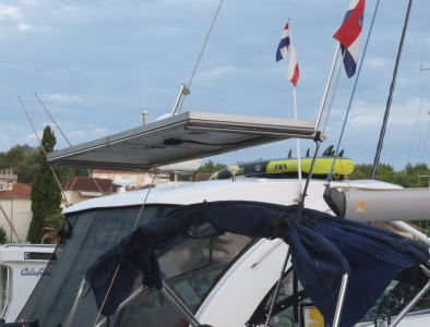

If you have no space anywhere to put them then consider either an arch, on the guardrails (the suggestion from @geem) or on top of the bimini if you have one. If possible use rigid panels, they are more reliable than flexible.
Backstays are also getting popular ...
