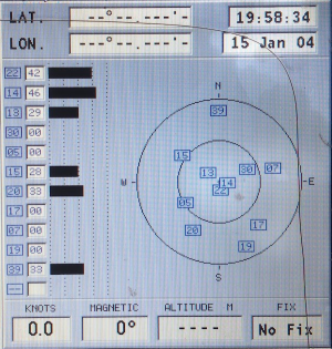

now comes up with this:
date is 15th Jan 2004, shouldn't that be picked up by the sat system and update internal time of the plotter?

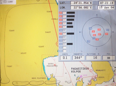

Surely enough, turned off power at 9AM, fired it up now (9PM) and took around 4mins to get a fix, although the screen was showing enough sats (albeit different # to the ones it had in the morning) and their strength in black and not red:

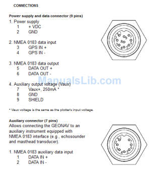

Are you sure you have the correct connections? It looks like you need pins 3 & 4 of the 9pin connector. You can power the 'antenna' from pins 7 & 8.

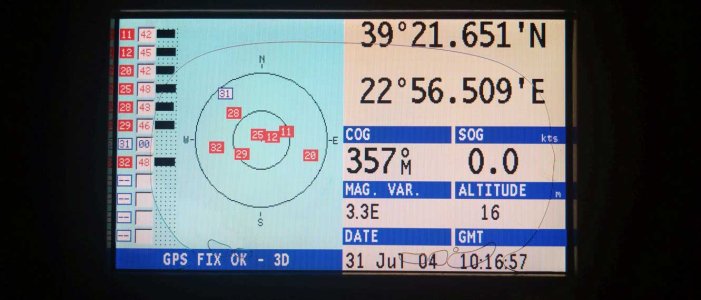

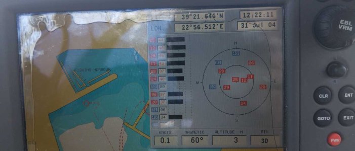

Both have decent 3D fix:
7in indoors:
11in f/b:
