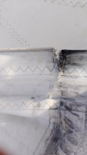

Hi all and many thanks for the replies. I mistakenly thought I had attached a photo.

Check where the top and bottom of the luff tape are on your sail.
They probably finish six inches before the head and about the same distance about the tack.
If that's the case I doubt there could be any vertical loading on the luff rope itself.
