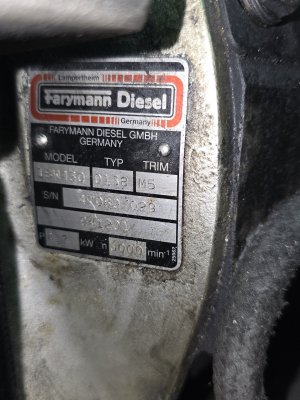

I have a Mastervolt Whisper 4000 which is actually a Paguro 4000 by VTE of Italy, in disguise. Also sold as Westerbeke 3.5 bcdt, and indeed the smaller Fischer Panda is virtually identical too.
When I had problems with it Mastervolt wanted silly money for simple parts, however Advance Yacht Systems of Romsey - Mr Rod Boreham was most helpful.
My unit has the Farymann 15W engine and parts for this part are available from commercial Diesel engine suppliers, e.g. Mitcham Diesels.
PM me if you want the various manuals I have for the Mastervolt and other generic variants of the Whisper 4000 and Farymann Engine. If it is the capacitor RS or similar will be able to supply a suitable unit - make sure the Microfarad rating is the same and the working voltage is at least the same or higher.
