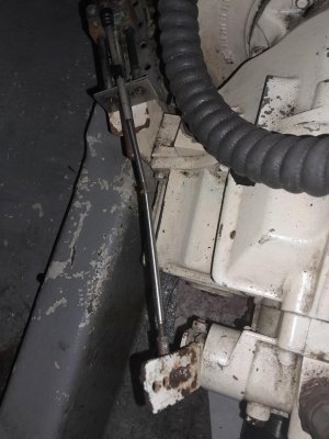

I have Hurth 800 A2 and the linkage was knocked/fell apart during the engine service. Looks as though the inner threaded rod has previously been damaged, and only had two threads to screw in, the engineer is going to "tap and die" (if thats correct terminology) more thread, but I wonder whether should be longer, and also thinking it would be good to inverstigate the port engine's linkage too. But as everything currently open & accessible, whether simple replacement of the whole lot would be a better option.

However here's the SB gearbox end without the errant rod (which the engineer has to rethread)

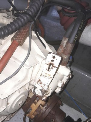

And the port one complete with a bit of a kink in the connection, so suspect not much thread also

This is how they come asap-supplies.com/products/ultraflex-c8-33c-type-control-cable-10-9m-36ft-4-c8-36 and the fitting that is attached to the lever is a separate item. The fixed point for the outer cable normally goes in a clamp on a bracket attached to the engine at a fixed point from the lever so that the screw end on the inner cable meets up with the fitting on the lever with room for fine adjustment. Yours does not seem to be a standard arrangement as there is an extension to the inner to compensate for the fixed outer cable clamp being further away from normal.
Agreeing with Tranona as well as noticing that it doesn't currently align which is the most likely cause of the bend and even if you replace with a new one the same will happen .
Someone has twisted the gear lever so that the cable sits flush but that doesn't help at all with the push/pull angle.
The fixed end needs to be on a bracket where the flexible black pipe currently sits .
I would expect there are two pre tapped bolt holes in the straight bit shown on the bottom photo just above the flexible black pipe , that is where you need to re site the cable fixing.
two holes in similar gearbox here https://bpi.ebasicpower.com/mm5/graphics/00000001/ZF45A_thumb.png
