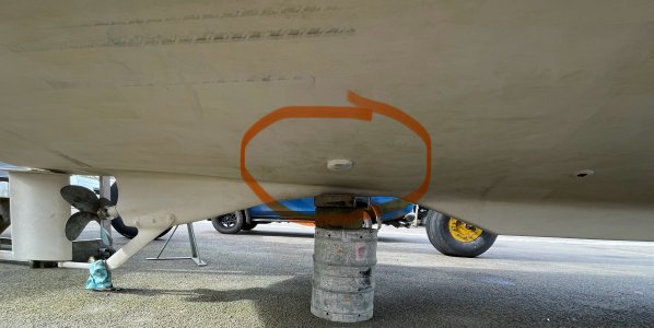

I’m back at the boat & wondering about this spot, it’s between the keel & the skeg, it’s at the side of the engine & 5’ infront of the propeller .
**Edit: scrap that idea..I thought it was a temperature sensor but it’s the water intake 🙄

Ok having now seen the hull I think you should get the second transducer and the Y adaptor, if you want it all to work well.

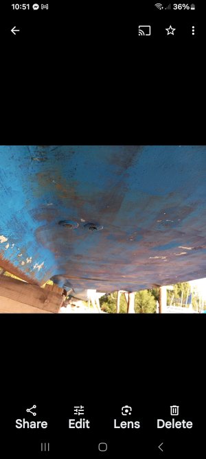

Below is a picture a picture of my setup on the same boat as yours. But, I'm only set up to show depth. The inside (nearest keel) is the depth transducer and the outside is the paddle wheel. From the inside of the boat, they're just forward of the battery compartment.
I'm wondering if you moved yours further away from the keel it would have more vision Screenshot_20240406_105156_Photos.jpg

Col, he already has the hardware. No point debating whether he needs it! (though it is very good kit imho)
Moving it away from keel doesn't solve anything with these sidescan transducers. The pictures on this Garmin page show the problem - keels and high deadrises create blind spots for these sorts of transducers.
