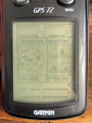

I’ve had this a long time and it still works fine. On a longer trip I use an iPad for navigation but just out for the day I have the GPS72 running to log hours and show speed. The screen is grazed and gone yellow so visibility is not great.
There is no gap between the screen and the body and taking it all apart is a step too far.
I’m thinking of cutting the screen out from the front and glueing a new piece of acrylic in place.
Any better ideas?

Although it may not be obvious how the unit could come apart it presumably is possible. Vendors on Aliexpress offer replacement screens, for example: here
If you think it's a possibility then maybe ask if they provide instructions?

It's badly crazed right through. I've order a new cover. Thanks for replying.
Hi, I have a GPS72 that does not work fully owing to a damaged circuit board. The screen is in good condition and you are welcome to it or the whole unit for spares. I will be able to explain how to take unit apart and replace parts which is not difficult.

Thank you. I’ve sent for a replacement cover but if that proves too difficult I’ll message you.

I have split the case on a GPS 72 to get to the circuit board battery to change it.
Just remove the 6 small screws (v small Posidrive heads) on the back of the case ( one is next to the batteries - you must remove the battery cover for that one). then wriggle the front to separate it from the wide rubber joining piece and the back. (maybe use a small knife blade to start them moving)

The new front arrived. It was quite easy to change over. The electronics are not fixed to the cover and can be prised out gently. Very small Phillips screwdriver and a knife. Now looks as good as new.
