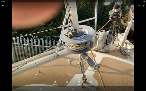

Can anyone confirm if this is loaded in the correct direction. The instructions say to load the line in the direction as indicated by the reef arrow.

Your photo shows two furlers, one selden and one rotostay. Most furlers furl anti-clockwise viewed from above. Some rotostays furl clockwise viewed from above. Load the line up so that when you pull it the drum turns in the direction of the reef arrow on the furler. Photo looks as if you have got both furlers set correctly.
The Rotostay is different because of the way the foil is attached to the drum.

Thanks, this is the information I was looking for , my staysail has no uv sacrificial strip . I was more concerned with Rotostays reference to loading direction
Thanks i see now the loading is correct. It was one of those, I think its correct but ile ask the audience moments.
