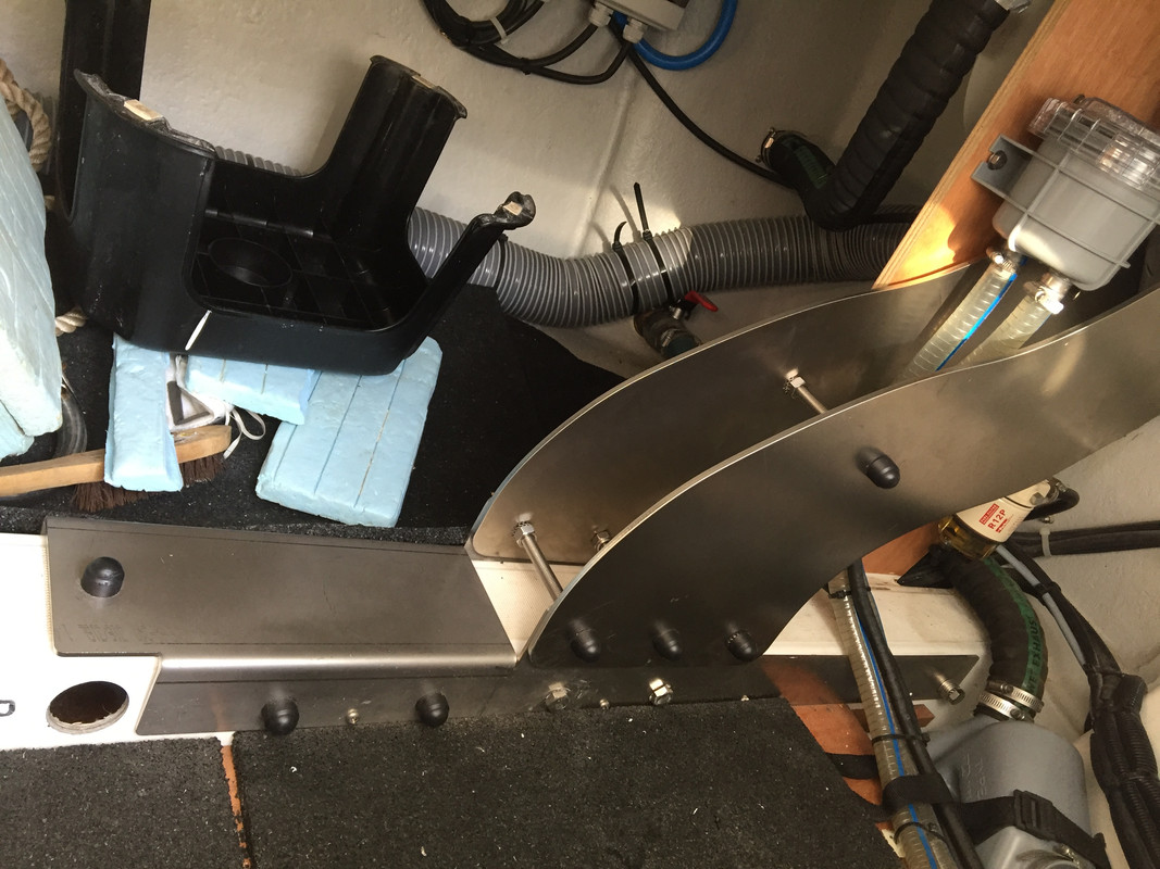

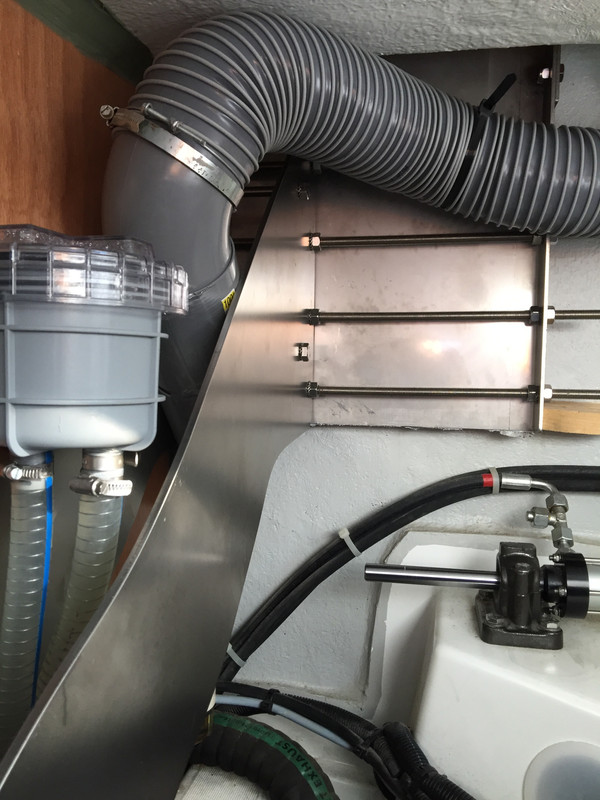

This is from my archives…all the stainless is 316 and very large and very thick…also there is a extremely thick plate up in the gunnel where it can’t be seen in the photo
There is hardly any flex…even fully extended with my very large friend (close to 300 lbs) stepping on and off. However, there is a little bit..just a little flex…but much much less than any boat I can observe (including superyachts)…that is except Princess…they are rock solid, no flex. So my plan was to insert three very small stainless steel triangular gussets..just to beef it up and match Princess quality.
Unfortunately.,..my plan was to do the work in winter (it’s too hot in the lazaret in my welding gear in summer)…so it will be next winter…no big deal ?

I am sure that Itama also don’t flex? But most won’t flex while lifting a tender..it’s a slow steady lift...but when people step off and onto the tip (especially when fully extended) it has that sudden springy effect....in fact I have observed that many people either don’t extend the passerelle fully (or step on and off the side) in order not to have that springboard effect
