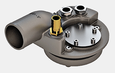

Diesel tanks can be welded while containing fuel so I don't really see the fire danger. The pipe will also be above the tank, using a Vetus fitting:
But I will use the proper fuel pipe. I just wondered.
