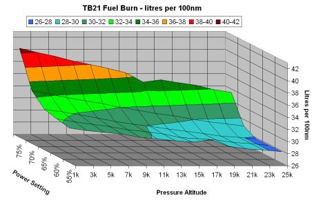

Being a nerd, I loaded published fuel burn figures for a light aircraft I used to fly into Excel to plot a curve to find optimum power vs altitude. Quite pretty it was too ..
