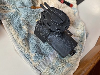

I recently discovered that the cooling pump on our seawater cooled Isotherm 5000 fridge is leaking, and has been for some time. I uninstalled it, removed the lid, and supplemented the oddly shaped double o-ring with a very light smear of sealant. Refitted it to the boat and ran it - it pumped water for a few seconds and then no more (pump was still running). So remove it again - and this time trying to pull the pipe off the barbed outlet spigot the spigot snapped off flush - so I think it’s time for a new pump.

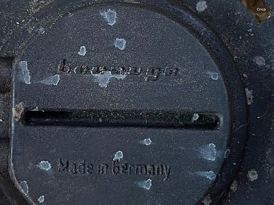

I’ve had no luck identifying the pump, and can’t make out the only lettering on it:
It’s at least 30 years old, I suspect long obsolete but if anyone can identify it it might help.
