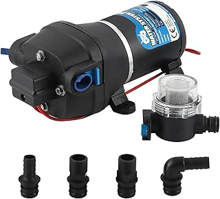

It's not this exact model, but it looks this: Jabsco Parmax HD4 12V 25Psi Pump

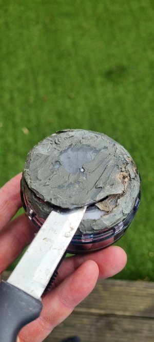

I had a problem with my jabasco earlier in the summer. It would work fine with the tank full, but once it got down to about 1/3 remaining it would keep often fail and leave the pump running, but not priming!
I couldn't see any drips or hear any air leaks but I did notice bubbles in the strainer that connects to it. Turns out a previous owner had tried to remove the strainer cracking it in the process. Then kindly repairing it with a smudge of silicone of the top of the crack! Anyway replacement strainer and now she works better than before. 20240710_165743.jpg
Not sure of if I've done the pic right of their handy work
I couldn't see any drips or hear any air leaks but I did notice bubbles in the strainer that connects to it. Turns out a previous owner had tried to remove the strainer cracking it in the process. Then kindly repairing it with a smudge of silicone of the top of the crack! Anyway replacement strainer and now she works better than before. View attachment 182414
