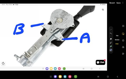

Nothing wrong with the gearbox. The control cable is not connected correctly at the lever end so it is pushing when it should be pulling and V/V

Look at the back of or inside the single lever morse controller - you may see the throttle cable in the centre and the gear cable attached to a circular bit, either top or bottom. Changing direction of lever for forward may simply be a case of re-locating the gear cable from top to bottom or vice versa, without changing the 'adjustment' on the cable - but may be worth while getting a local mechanic to check the tension/adjustment as on mine there is no slack so has to be set correctly. Yours might be different of course. Back for forward and forward for reverse is like an old fashioned car gearbox and as on our automatic,

You'd love my Progress4 speedboat then ... that has exactly same !! Back for Ahead .. forward for Astern.
Why ? Its not just a matter of wrongly connected - its because the cables are too short to allow connection other way round. The Throttle lever and mechanism can be connected from either side ... but this means that the cables have to be longer to accommodate the extra curve to connect. I could easily buy longer cables to correct it ... but TBH - I am so used to it now .. I'll save the money !
I suspect that you have just acquired the boat ? That previous owner may have installed the cables ? You may be lucky and find that gearbox cable can be long enough to swap to other side of lever ..... only you can see this by unmounting the lever and checking ...
As egret has started, it may be as simple as swopping cable position A to B or similar.
Yes - true - but it MAY be like mine - the cable is short and not able to make the extra curved route to the other side connection. The length difference for me would an extra 2ft ... to get a decent gradual curved approach to throttle handle.

Well, thanks everyone, it was in fact a Vetus control not a Morse but the principle was the same as the schematic Rappey posted above. A fairly easy fix of you ignore my bleeding knuckles & working in the confined space of the quarter berth. Anyway, done now and tested so thanks again.
Well done ... maybe one day I will buy a longer cable for mine and do similar !!
