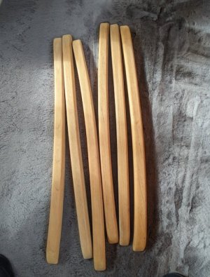

I've finally worked out what the 6 lengths of curved teak are that have been liviing in a wardrobe, unused, labelled as Port 1, 2 3 and Stbd 1,2 3.
They're toe rails to fit on the edge of the grp moulding under the guard rails...

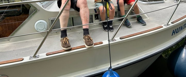

Mine are sikaflexed and screwed to the deck with 4 or 6 screws depending on length of them
For handling ropes in the canals they are great for getting that bit of extra safety and grip

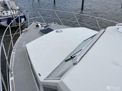

This is how they looked when we bought the boat
View attachment 200500View attachment 200501
