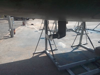

Yes Had one for 10 years on 2 Bavarias same engine/drive as yours . You won't notice any lag at all. Talk to Darglow Engineering for the correct size - probably a 16*11 Excellent choice.
