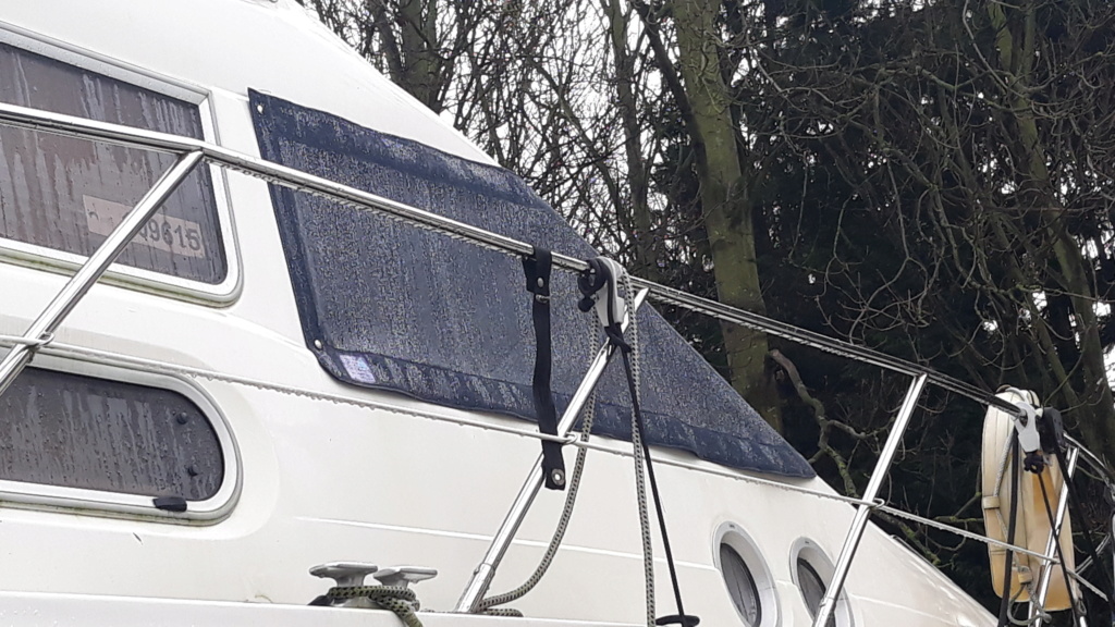

I have been using a white pvc cover which came with the boat .
However the chief officer wanted to be able to see out with the cover in place while providing privacy and also offering some protection for the interior against sun.
So we had a new mesh cover made before christmas .
