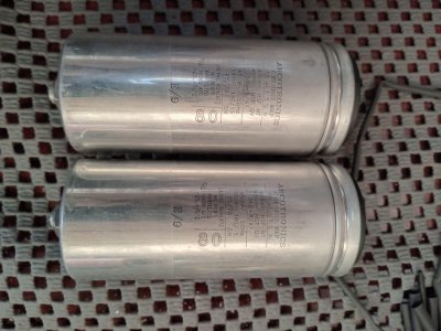

My generator runs but does not produce electricity. I've been told its the condensers If so where in the UK can I buy replacements. Don't know if that's the right name for the part I will try to attach photo. I don't want service kit just these parts.

They are 80micro Farid Electrolytic Capacitors with a 450Volt limit at 50 Hz
There is a manufacturer and ID number that Google may help you locate a supplier of just Google the specification for a suitable alternative

The part number in your photo is shown as C870EG3 and the manufacture Arcotronics. Arcotronics are now Kemet part of Yageo. That part number does not exist anymore but the closest I can find is this...
Product
If you click on the datasheet link there is an explanation of the part numbering system. The second C in the new part number that was E in the old part number refers to marking, which is unimportant. What the old part number does not indicate is terminal style which is the 5 in the new part number. I can't see the terminal style in your photos but I suspect it is different. If you used that part you may have to make up some connectors.
