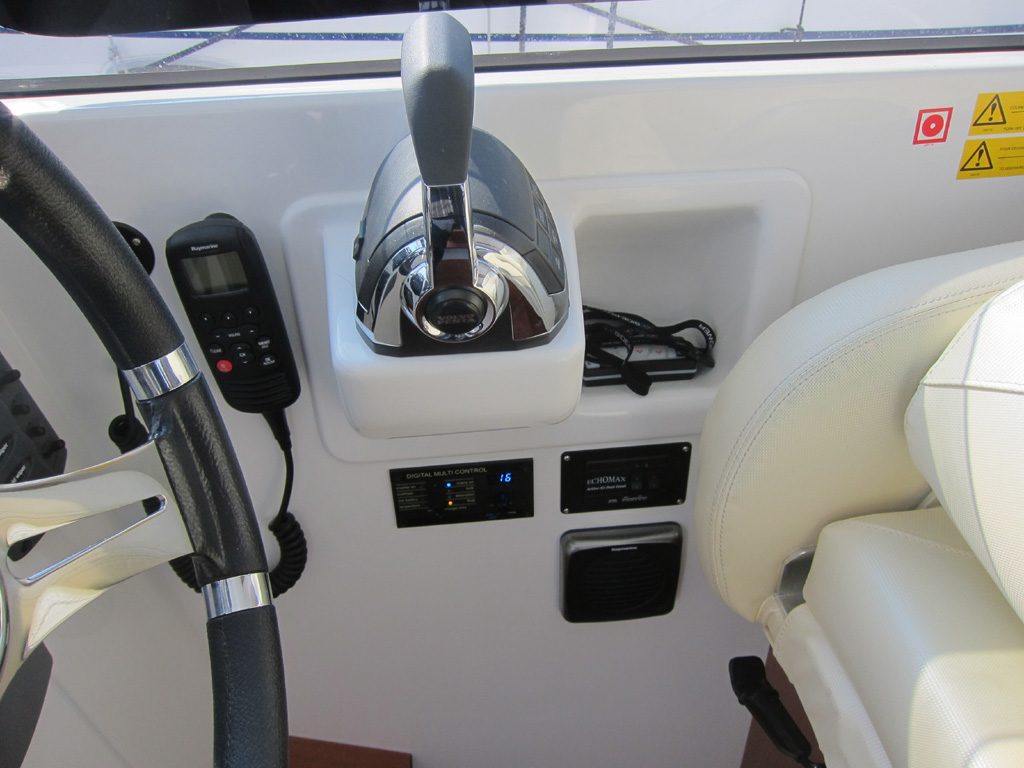

you can see part of the controller bellow the thruster controls
Ops, I did see that dashboard pic, but didn't notice the controls. :o
And neither I spotted them on the stern in the video (hence my question), but that was probably just a bit too dark...

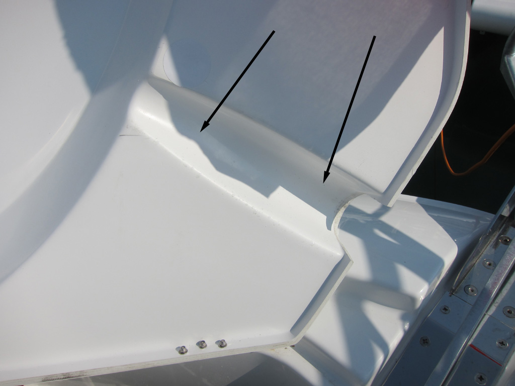

I think the main problem with the chain going in to the front of the anchor locker lid is the leading edge, I was going to grind it off somehow to give a little more room - It seems to hit only when the shaft of the anchor rises over the rear roller, Is your Rockna a 15kg?
All chain rode looks good
My SS in the recess was made to go up the sides of the recess as well, as I found when retrieving, the chain would shake violently from side to side sometimes, it actually hit the side and made minor damage.

Sorry I forgot to reply to this. Yes it's the leading edge that catches with lid closed. I did some anchoring at the weekend with dad up front locker open when lowering / raising anchor. The swivel / shackle set up seems to self-right the anchor every time, dad said he saw anchor rotate around. No jams on the all chain rode yet, most I've let out is 25m to anchor in 6m water. Early days yet though, only anchored three times. Rocna anchor has worked a treat, set first time all three times.
