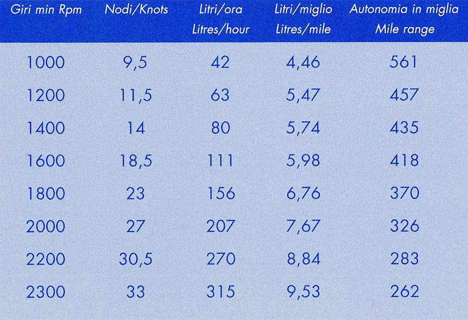

So that’s why I have previously questioned you figures a pair of 800 s pushing 27 T with a bigger wet area cant burn less than my 700 s anything between 17 to 20 T with a smaller wetted area.
Yep, I remember that we already debated this in the past.
And we can speculate about the reasons till the cows come home, but my numbers are based on empirical evidence, anyhow.
As you know, you can only have a real time fuel burn through either electronic engines displays or flow meters, and I have neither.
But the delivery trip that I previously mentioned was a fantastic opportunity for checking fuel burn numbers VERY accurately, for two reasons:
Firstly, the long distance (with the outrageous overall amount of fuel used!), and secondly the sight gauges on tanks, whose movements I could trace to the millimeter.
Btw, that trip was before I pressure checked and tuned the injectors, replacing also their nozzles.
A job after which I never had the opportunity to make a comparably accurate fuel burn measurement.
Not that I expected miracles, anyhow. But I did experience a noticeable reduction in exhaust soot after the job, so I think it's safe to assume that if there was any effect on fuel burn, it wasn't for the worse.
Interestingly, the results of my empirical measurements were so close to the numbers in the builder's brochure, that I didn't even bother making my own table just for very minor differences.
I think to have already posted it in the past, but I'm re-attaching it below, in case you would like to re-check it.

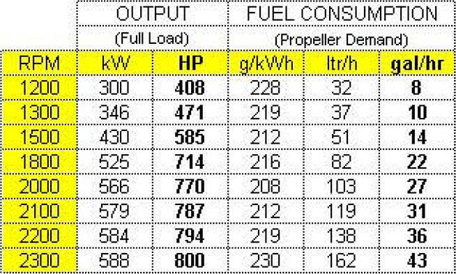

And under that first table, I am also attaching an abstract from MAN original specs sheet.
As you can see, they are remarkably aligned, so it's not like they had a magic wand, at DP.
Otoh, I did come across several P boats whose fuel burn was significantly higher than the prop demand curves of their engines.
But that ain't a surprise either, because those curves are just theoretical, and in principle closer to the behavior of D boats.
My personal inference is that weight aside (which remains a big factor of course, but with pros and cons), there must be other more subtle ways to optimize the efficiency of a P hull, through hydrodynamic lines, propulsion design, weight balance, whatever.
And on top of that, there must be also other factors involved, when comparing radically different things like a flybridge and a boat like yours.
For instance, surely fuel efficiency has never been one of the good reasons why most builders of fast open boats typically go for a deep V bottom.
But as I said at the beginning, when it comes to the reasons for these difference, we can only make armchair speculations.
And rather useless too (academic interest aside), because as Deleted User said, it doesn't really matter, at the end of the day. :)

Yes the charts are good . The WOT figure complies with the Hp / 5 calcs for reference .
So we are on the same hymn sheet .
Only explanation is dead rise even a few degrees more has a disproportionate effect on drag in terms of displacing water and wake creation .Perhaps the faster I go with a deeper V it takes more energy to shift the water sideways
This eats Hp .
How ever if I was to go the same cruise speed as you 22/23 my consumption drops to around 60 to 65 Lhr making my 120 /130 Lhr which now fits as expected under your 156 / 160 L/hr ,
So at the same planning speeds not surprisingly yours burns more .
If you raise your cruise to my near 30 knots your charts indicate 2180 rpm and 215 L hr .For my 1950 rpm 190/200 L hr
correct pecking order is maintained .
The discrepancy between the boats consumption I highlighted in previous posts was because I erroneously compared our boats at different speeds .Doh ! :)
So back to the Op your bigger + heavier DP 58 boat with 2x800 Hp MANs uses the same fuel 160 Lhr @22 knots ish as the Ops proposed F43 with VP 480 ,s
Both boats fit in with the Hp / 5 consumption rule ....so you can,t blame VP for being a bad engine .......so your DP hull must be remarkably efficient @ 22 knots which you have been saying .....now I agree. (y)
