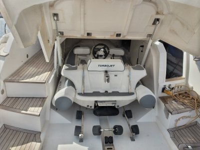

It's a bit exciting, will do over 40 knots. Jetski donk in a rib, kinda.
Delivery from mainland Spain was a bit of a saga, it had to go to Gran Canaria first for customs to pat it. The pallette got stuck in the lorry too.... However all is well now, lads in the boatyard all over it like a rash, checking everything in order and getting promised trips out!
The brief outing today ended with a good drenching for my friend and his wife....I laughed. Anyway, windy again tomorrow so sea trial postponed until flatter sea forecast for next week.
So tomorrow we're gonna figure out how to get it into the garage on his Fairline 47 targa. Was originally gonna go over to reception pontoon to sort it but it is forecast really gusty tomorrow. Plan B is we will warp the boat forward about 10 or 12 feet (plenty of friends ready for rope evolution) so we got time to work out how the winch copes and how much deflation is needed, yadda yadda.
Next week yippee, blast away!

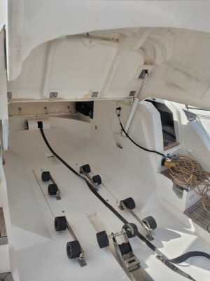

Well kinda as expected...mostly successful but a few mods required.
The roping party worked perfectly, bow anscstern thrusters countering a strongly gusting beam wind. Touch of engine and hey presto. Reverse process afterwards, smooth.
Re pocket rocket. Getting on board quite straitforward with winch power. Also needed to fully deflate. Getting out was the problem. The aft set of rollers are too low. The v of the aft end of the rib Hull is metal and part of the jet drive. This catches on the centre rollers and the rib is extremely very heavy to lift over with manpower. So my friends project is to make some plywood spacers to trial and error the correct height. Will eventually manufacture in stainless. Should solve snag and make it easy to do solo.
Also tested 12v inflator pump. I've always skimped on these for yacht tenders....now found out a proper job works ten times or more better!
Checked through engine flush routine....lots of aluminium parts that need routine care.
So once the deployment issues are solved and with mid week weather forecast going flat next will be sea trial.
