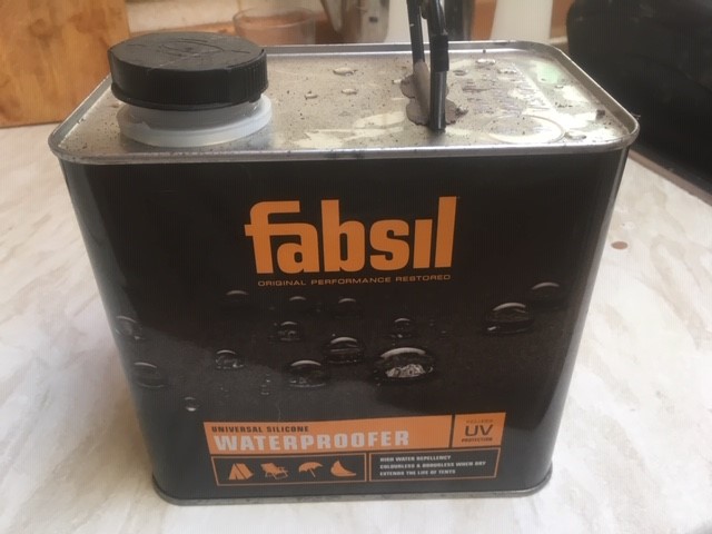

I hope I have not done the wrong thing. I just applied Fabsil waterproofer to my canvas tonneau covers. It had good reviews. Has anyone else used it to good effect. It also claims to be a protection against UV

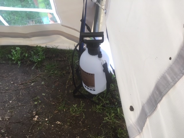

I applied it with a £7.50 garden sprayer I got from screwfix. Then wiped it over with a Clean dry cloth. That seemed to 'push in' the beads of fabsil on the surface.

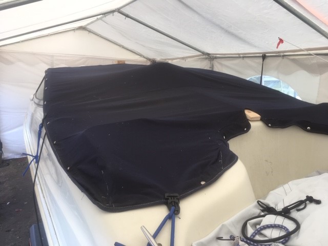

Here it is in the tent drying as it needs 6 hours.

Yes I saw the Fabsil gold but I had about 1.5 ltrs in a tin I had a while ago. Apparently it lasts in the tin for ever. I have some other covers on other boats I could do so I might give the gold a go
